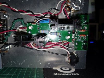

Picture attached

    • Posts: 20295
Reply #3 on: May 18, 2019, 07:01:07 AM
G - 223
G is the ground connection, are you sure you have this connection wired to terminal 3?  If you do, then you almost certainly have a faulty solder joint on a ground wire in the original build (the black wires that go from the RCA jacks to the volume pot, to terminal 3, to the headphone jack, then back up through the power supply built above the power transformer)

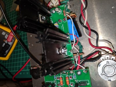

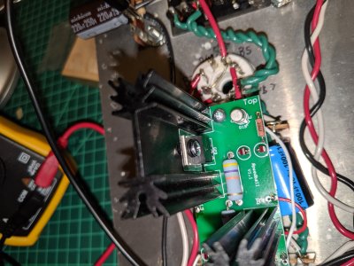

I would recommend double checking the installation of your TIP50 transistors, and more specifically that the hardware is installed in the exact manner described in the manual.  The symptoms you're describing are consistent with a TIP50 metal tab that's making metal on metal contact with a heatsink, and this will cause damage to your Crack if it's run for very long.

Photos on the TIP50
