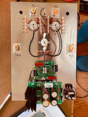

Working on my Eros2. Completed the Power Supply. All voltage tests on the money. Moved forward to Shunt Regulator.
Got to voltage check and voltages were way off. As I was getting ready to make note of the readings, the resistor at AR4 sparked and fried itself.
Thanks in advance for the help.
Alan

Reply #1 on: June 10, 2019, 04:05:24 AM
Would it be possible to upload larger images?

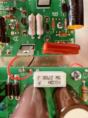

Reply #2 on: June 10, 2019, 04:27:25 AM
Hi Paul,                                                                                                                                                                                           Hope these work could go higher if your blog system will accept them.

Reply #3 on: June 10, 2019, 05:02:19 AM
You have RC and R4 switched.
You can try replacing those parts and firing it up, but be aware that you may need to replace the whole board.

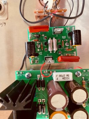

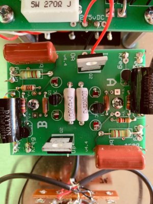

All parts and PCB arrived. New Shunt Regulator built and installed. No fires during voltage checks however while voltage check on B side was 207VDC, A side was 300VDC. Picture of build below. Your thoughts please.
Alan

Reply #9 on: June 25, 2019, 01:14:19 PM
Reflow the center leg of each MJE5731A.  They take a lot of heat to solder properly, and the output being about equal to the input on a C4S is usually caused by that leg having a cold joint.

Reply #10 on: June 26, 2019, 05:44:25 AM
Reflowed the center leg. Viola, good readings. On to the Audio Circuit.
