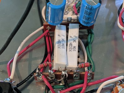

This was my first time assembling an amp--got to the voltage check and had some high voltage readings for some of the terminals. Results below:
1. 145
2. 163
3. 0
4. 164
5. 148
6. 0
7. 146
8. 0
9. 147
10. 0
Also neither the LED attached to A3 or A8 lit up. I'm attaching photos.
What should I be troubleshooting here first?

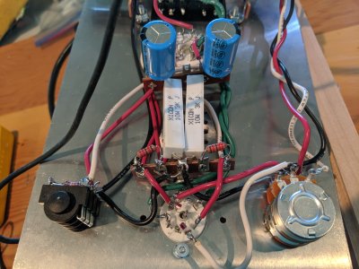

Re: Voltage too high/LEDs not turning on
June 13, 2019, 01:08:45 PM
More photos just in case.

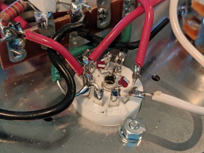

Reply #4 on:
June 13, 2019, 01:33:13 PM
Shouldn’t there be a black wire on the center pin of the front tube going to the pot?
Reply #5 on:
June 13, 2019, 04:32:07 PM
Ah, thank you so much Jameson! That was it, I had somehow totally omitted that during installation. Soldered that one in, voltage readings are correct and the thing sounds AMAZING!
