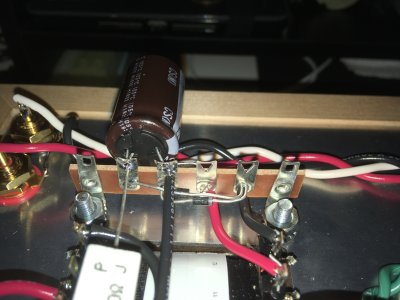

If you’re getting noise when you tap the chassis it could be a loose or undersoldered connection. Could you post some pictures of your build?

The more the better but probably want to focus on the area around the input and headphone jacks and tubes. And maybe take a pass through the hardware and make sure everything is tightened down.

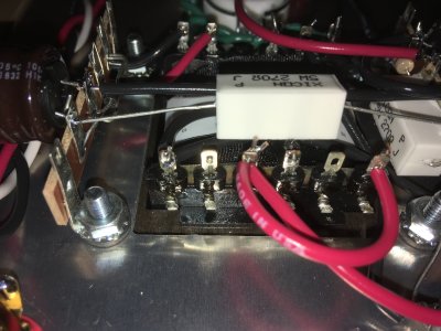

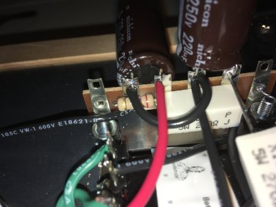

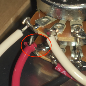

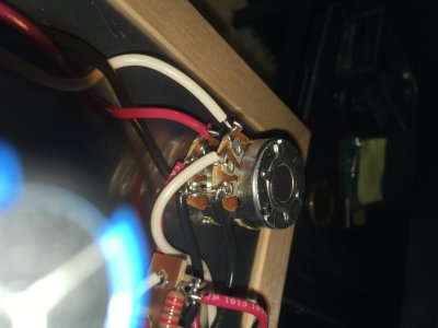

Here are some pics:
Offline A Jedi
    • Posts: 68

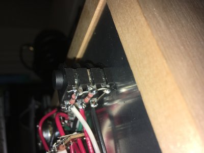

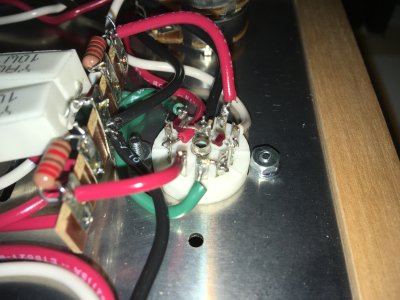

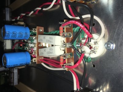

Reply #12 on: June 22, 2019, 02:09:17 PM

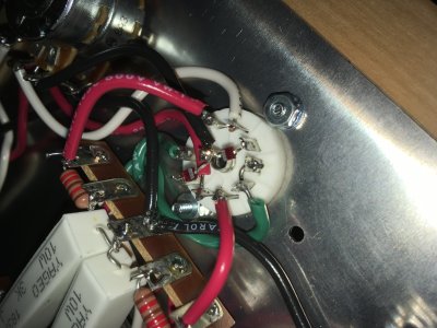

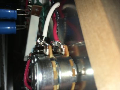

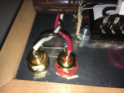

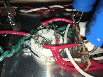

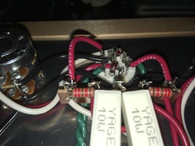

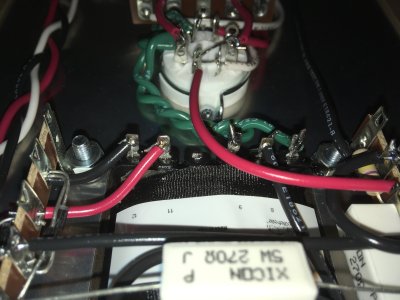

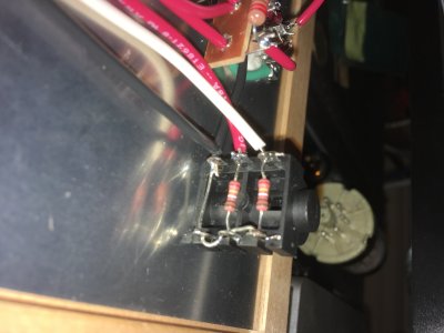

And more
