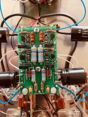

Been moving along slowly and carefully since previous issue. Just completed build, Resistance checks are perfect. Some of the voltage checks seem to be out of the 10% +/- range, Particularly 1A and 1B.

IA and IB come from the regulator that's built on/above the D socket.  If you remove those blue wires from IA/IB on that main C4S board, what do you now see at +reg on the C4S board above the D socket?
It is possible that there's still an issue at the D socket that needs to be resolved.

  A side +reg  196.5 VDC
  B side +reg  291.00 VDC
    • Posts: 20296
Reply #3 on: June 29, 2019, 06:09:02 AM
Yeah, at least one side of your regulator board isn't working again.  I would recheck your Kreg voltages and double check those D socket connections again.

Just finished total check of D socket and Shunt Regulator Board. Now voltage at the MJE5731As is A @ 295, B @ 294.
    • Posts: 20296
Reply #5 on: July 01, 2019, 09:54:14 AM
So now neither regulator is working properly.  Are all the tubes still glowing?  What voltage do you get across the 6.3V terminals on the power supply board?

Tubes all glow.
Voltage is 6.3vDC.
LEDs on A side of shunt regulator light up and are steady. LEDs on B side flash several time and then go out.

My mind is spinning. Keep going over everything touching up solders, etc.  Found a mistake. White wires from D socket went to the wrong kregs. Switched them. Reattached wires to IA and IB. Only 2 voltages now outside the range.

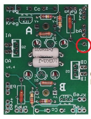

With the Kreg wires properly installed, how did the regulator board check out before you hooked it back up to the front C4S board?

A Side MJE5731A   220VDC
B Side                   177VDC-off by 15%
    • Posts: 20296
Reply #11 on: July 03, 2019, 06:08:59 AM
OK, I would leave the IA/IB wires off the smaller C4S board and debug the shunt regulator.  What are its Kreg voltages?
Offline adeep42
    • Posts: 218
Reply #12 on: July 03, 2019, 06:29:59 AM
kreg A   3.21
kreg B    .625
    • Posts: 20296
Reply #13 on: July 03, 2019, 06:40:55 AM
What's the voltage at the X terminal on the B side?
Offline adeep42
    • Posts: 218
Reply #14 on: July 03, 2019, 06:48:27 AM
175 vDC
