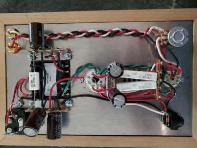

It might help also to post images of your build.

I apologize for not explaining it better. I got proper readings from the transformer at the begining of build but never had proper readings from the terminals. I have gone over the wiring again this afternoon and it looks right to me? I have attached a picture if that helps.
Troy

The picture shows neither of the led's fitted. Are you replacing both?

I think Deluk's question above is still relevant: your build pic shows two LEDs missing - did you remove them both?  If so, did you keep them? If the leads are still long enough you could try re-installing them and then progress with the troubleshooting.  The first step of which would be to redo the resistance checks, and if that checks out ok, to redo the voltage checks. Post any deviations from the values specified in the manual.
