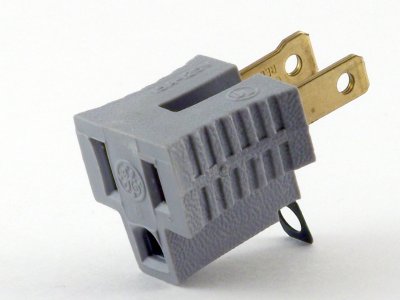

You can also try a cheater plug on the power cord to see if that disrupts the noise.

interconnects are in. Excuse my ignorance, What is a cheater plug?
    • Posts: 20291
Reply #5 on: August 18, 2019, 05:47:55 PM
Like this.

Paul, got a cheater plug, no change. Am using a Rega TT in this system. Rega doesn't use a separate ground wire. They have their own way of doing things. Am looking into how to do a separate ground. Also will switch the Eros 2 with my other Eros. Just need the time to do everything. Your ongoing help is most appreciated.
