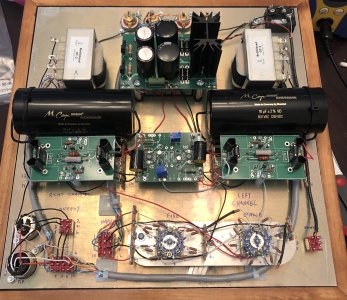

EDIT: Adding a photo just in case you guys see something clearly wrong that I missed

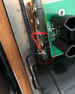

EDIT:
Decided to look under the hood to see if any connections seemed suspect. Does this one seem okay to you guys? Or does this look cold to you?
