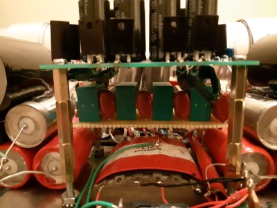

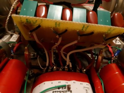

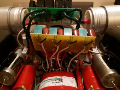

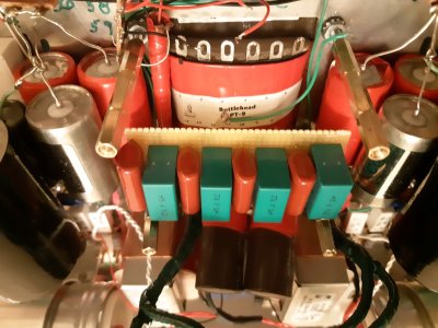

Installed the snubbers in the Kaiju tonight. It was a lot more difficult than I expected. There was very little space to work in, and getting all the wires through the small secondary terminals was a challenge. And ... I miswired the 300B heaters the first time 'round, forgetting that one of the heater windings wraps around the other. All in, it took me nearly 8 hours to assemble the board and get it installed - although probably half of that time was spent just staring at the task at hand. I'm a little trepidatious about installing the snubbers in the BeePre b/c I'll have even less room to work with.
Haven't fired it up the Kaiju and tested voltages yet. Will try that tomorrow. [Edit: checked voltages first thing this morning and everything seems A-OK. But I can't listen until I get the BeePre put back together] But here are some pics. I've included one of the miswiring b/c it provides a clearer view of the underside of the board.
cheers, Derek

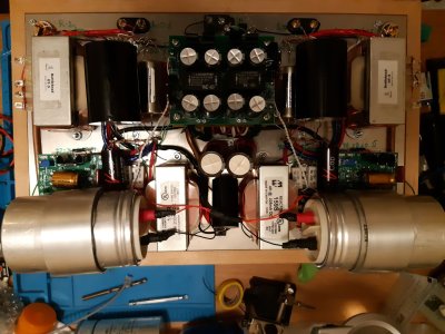

Deke609
And here's a shot of the entire underside of my "FrankenKaiju".
cheers, Derek
