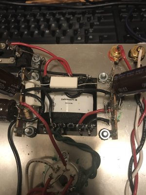

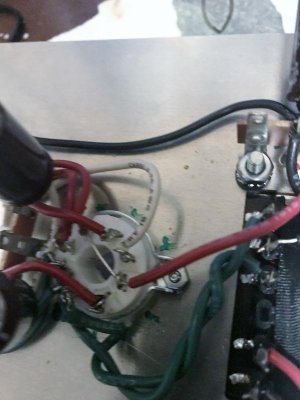

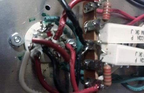

Can you post some photos of the build?  A channel that pops and drops will absolutely show a voltage problem, as pops come from important connections being intermittent.  Sometimes it's tough to get those connections to act up and to be able to get voltage measurements while that's happening.
Offline hibuckhobby
    • Posts: 23
Reply #4 on: November 12, 2019, 06:26:20 AM
Hopefully these will be better than my last efforts.
« Last Edit: November 12, 2019, 06:29:17 AM by hibuckhobby »
Online Paul Birkeland
    • Posts: 20292
Reply #5 on: November 12, 2019, 06:30:02 AM
The 9 pin and 8 pin tube socket wiring will have the connections that could could cause a channel to drop and pop, as could potentially the headphone jack.  The power supply that's built above the power transformer is common to both channels, so an issue there would cause both channels to drop.

Reply #7 on: November 13, 2019, 04:05:45 AM
On bh1 has the green wire broken off?
