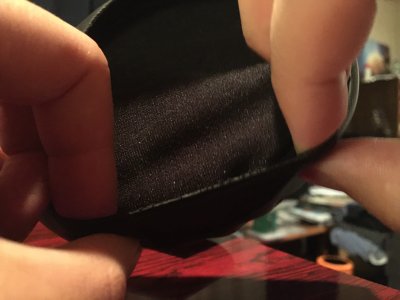

Hi Stefan!
You're welcome! And yeah, I'm using Brainwavz hybrid angled earpads (https://www.brainwavzaudio.com/products/headphone-memory-foam-earpads-angled-hybrid#prod). They're actually 30% off right now directly from Brainwavz, but are available for a little more on Amazon too.
They make the headphones so much more comfortable, by letting your ears not touch the driver grilles of the headphones. Also, bass is more prominent and the sense of space is widened. I tried the all-pleather Brainwavz version as well, but the airtight seal made the bass too strong and the overall sound too muddy for me.
TIP 1: The earpads will require a little pre-stretching before putting them on. I gently pull the elastic edge that flaps over the earcups (see 1st attached photo)--pull gently, then move on to the next area, all the way circumferentially. Then do a couple more rounds, each time pulling a little bit more. In the end, they should be noticeably wider diametrically.

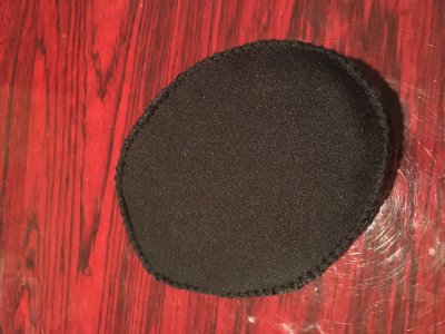

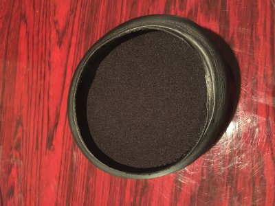

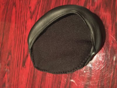

TIP 2: When installing the earpads, I invert the flap (see last 3 photos), place the pad on the earphone, then flap over the pad little-by-little on the earphone, while holding in place what's already flapped over.
