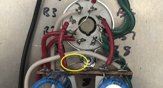

Reply #6 on: December 27, 2019, 09:28:25 AM
Not sure if this is related to the problems you're having, but you have some leads that need trimming, particularly the one circled in the attached. It looks like it might be creating a short to chassis ground.
cheers, Derek

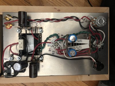

Thanks. Also just realized the right blue capacitor is getting warm but the left one is not. Hmmm.
    • Posts: 20262
Reply #8 on: December 27, 2019, 09:39:44 AM
A blue cap that gets hot could be in backwards, but I can't see that from your photos.
Offline kill_surf_city
    • Posts: 148
Reply #9 on: December 27, 2019, 09:41:24 AM
Oh shit you’re right! I feel so dumb. Thanks Paul. I’ll turn it around and report back soon
