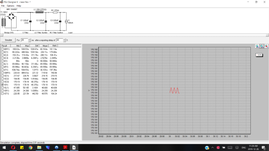

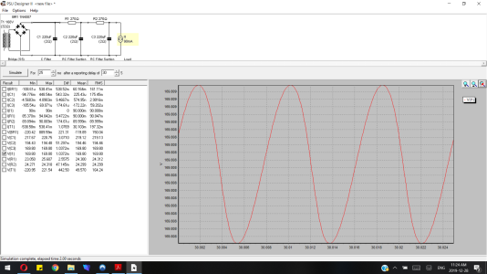

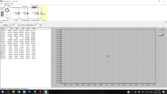

In PSUD2, either way reduces ripple to negligible levels - see attached pics of my very rough modelling of the Crack power supply (NOTE:  the current value of 90mA may be wrong - I used it as a ballpark estimate based on the CX7 rated max current of 90mA).
It is interesting that the stock CRCRC filter already reduces ripple to about 1mV peak to peak. Adding the CX7 appears to knock that down further by a factor of 10.  I'll be curious to know whether you hear a difference.
