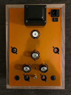

I’ve started building my Eros. I got the hardware installed today. Really digging the matte black on orange with the walnut base. I need to sand down the interior lip of the base to accommodate the added width from the powder coat, then apply the tung oil coat. Thanks to everyone for the recommendation on the oxide screws!
I’ll update as I progress through the build.

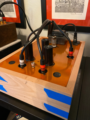

After a couple hiccups I wrapped up construction on my Eros today. Holy shit! What an amp! It's such a massive step up from the Reduction that I'm feeling comfortable holding off on the turntable upgrade I was planning in favor of a new set of speakers. Jagers maybe?
Many thanks to the Bottlehead crew for such an awesome amp, and also to the community for their eagle eyes. I still need to finish the base, but I'm too busy spinning some records.

Reply #5 on: January 11, 2020, 01:05:06 PM
Cool, I'm glad it went well, and it's looking nice.
