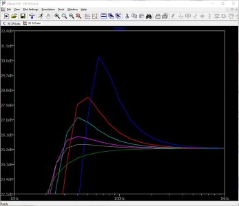

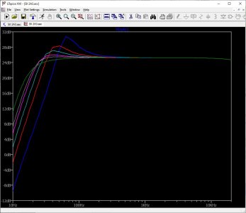

When you said optimize, I assume you want to know how para cap values affect frequency response. I've have attached some plots with different cap values: 1u, 2.2u, 3.3u, 4.7u, 5.6u, 8.2u. Load is a 200 ohm resistor.
As you might have guessed, the values mostly affects the bass region. (The 2nd graph zooms in on this region.) The 1uF value is the blue line (with the large hump.) The 8.2uF value is the dark green. You can probably see the trend with increasing cap values.
These plots are from a LTSpice simulation I had setup when I was planning to convert an SII for 45 tubes.
Actually, I was just parroting PJ's use of the term.  ;D  I wasn't sure (and still am not) whether PJ was referring to just frequency response or something else (e.g., power transfer as a function of impedance? - seems doubtful to me, as I think that would mostly be governed by the primary/secondary ratio of the OT, but I don't know enough for this to be more than a guess on my part).
Quote

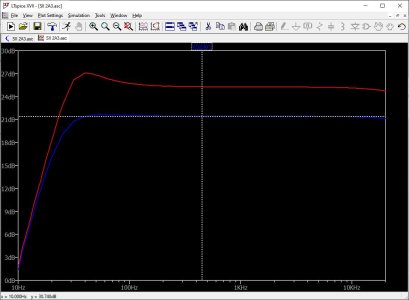

These are cool. Did the curves change much going from matched impedances of secondary and speaker to mismatched 16R/200R?
many thanks, Derek
Offline Raymond P.
    • Posts: 136
Reply #3 on: January 14, 2020, 10:36:44 AM
Cpara = 3.3uF
Blue = 16 ohm load
Red = 200 ohm load
The 16 ohm load has about a 4db lower gain. The lower gain makes sense since 16 ohms presents a lower impedance on the primary side to the parafeed cap. The hump is also reduced. I'm not sure what's creating that hump. It's probable some resonance going on created by the RCL network and larger values of C pushes it down to lower frequencies.
