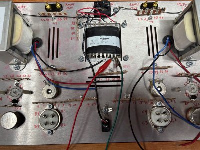

Hey guys. Started the Kaiju build and got to the first power transformer test. I’m seeing 119-120 VAC coming from the wall, but I’m only seeing 5.4VAC when I’m running the first test on page 33. I’ve reviewed the wiring a couple times, and I’ve tested continuity between each PT-9 lug and the terminal strips. I’m still not seeing 190 VAC. Here’s a picture of the PT. https://imgur.com/a/zwna7rr

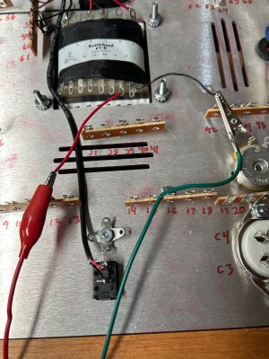

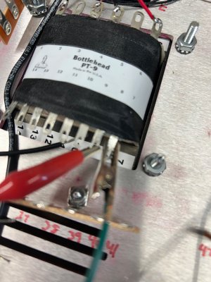

My page 33 power transformer tests are failing as well, but much more dramatically.  0.031 to 0.036 V AC on pins 7 & 8 AND a blown fuse.  I've redone the wiring with the same results.  Passes first power test with 126.4 V but when I follow the instructions for wiring for that range and run the tests it returns a tiny voltage and the fuse blows.
Other test results:
1/3 .041
9/10 .029
11/14 0.26
12/13 0.26
The Kaiju kit was delivered April 3, 2023.

Can you post some photos of your build so far?
