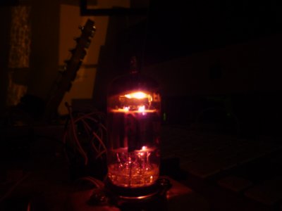

    • Posts: 20206
Reply #13 on: February 21, 2020, 09:19:05 AM
Inside the 12AU7 there are two plate structures.  Each plate structure has a heater that runs up the middle.  You may be able to see the bottom of each heater structure and/or the top of each heater structure.  If you can't see glowing dots on the top of each plate structure, then you need to look at the bottom of each plate structure to see if you have a glowing dot on each side.
If you have two glowing dots on the bottom of the tube, then that's useful information.  If you aren't sure, consider posting a photo of your tube glowing in a dark room.
Offline kattjaevel
    • Posts: 12
Reply #14 on: February 21, 2020, 10:14:05 AM
Sorry Paul, I see how my response may be unclear. I see that the heater closest to the front of the chassis, the one that sits on top of A3, glows. But the one that sits on top of A8 doesn't.
« Last Edit: February 21, 2020, 11:17:13 AM by kattjaevel »
