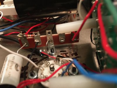

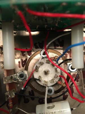

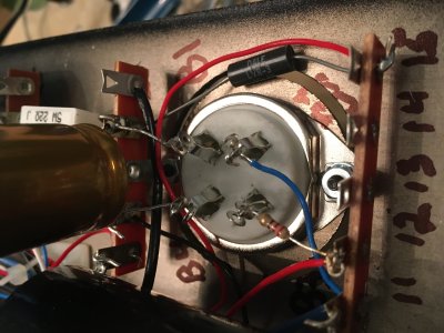

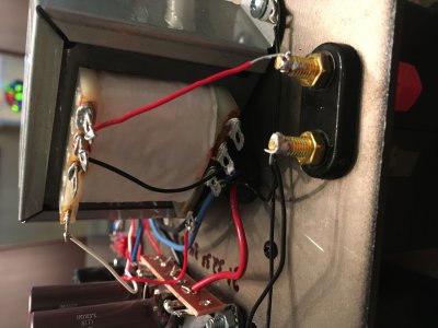

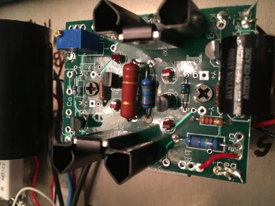

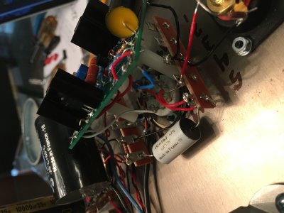

Reply #5 on: March 09, 2020, 01:32:06 AM
I compared the working amp to the non-working one and still can't find the problem. Here are some pictures.
    • Posts: 20290
Reply #6 on: March 09, 2020, 05:22:45 AM

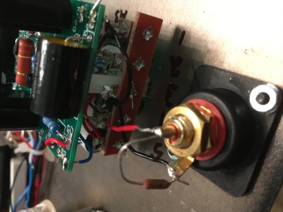

Reply #13 on: March 09, 2020, 04:47:55 PM
Well hey, that's helpful news. Can you unscrew the C4S board, lift it up a bit, then post a photo of your socket wiring?

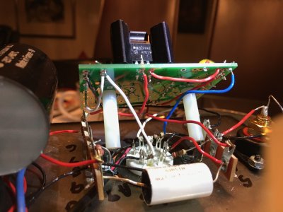

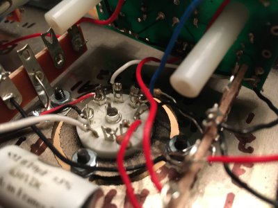

Offline keithp
    • Posts: 31
Reply #14 on: March 10, 2020, 02:44:52 AM
I took one picture with the C4S board pushed aside, then loosened the board to get better views.
