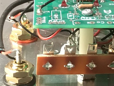

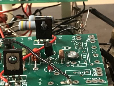

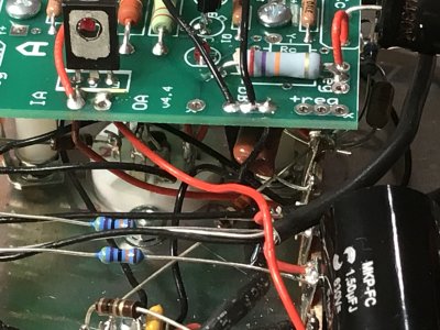

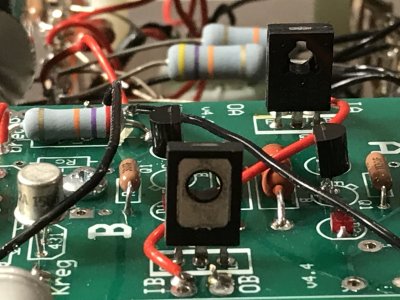

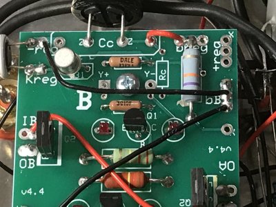

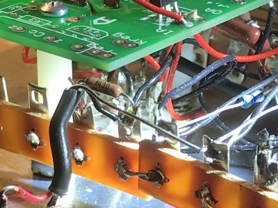

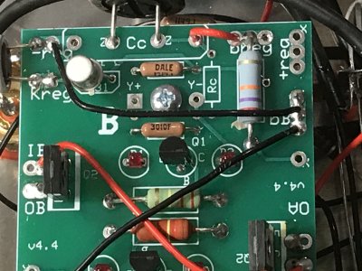

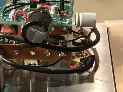

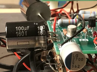

I would be interested in seeing some build photos.
One side of your Eros at least is working properly.
Offline PaulG
    • Posts: 26

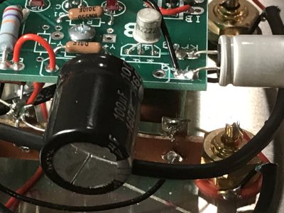

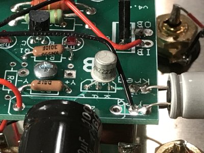

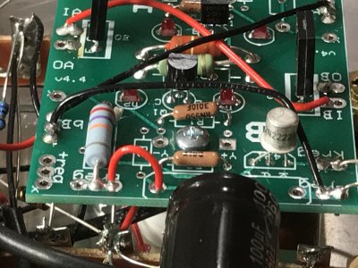

These are pictures of the left C4S board.
Paul Grisanti
Gentleman of a certain age
built Heathkits in the late 1960's
built two Audio by VanAlstine kits in 1990

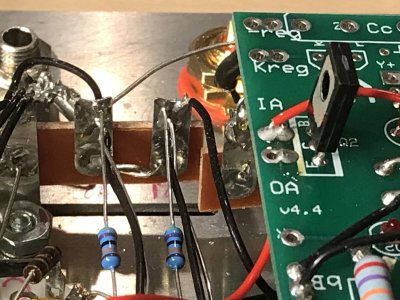

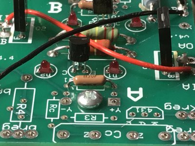

Offline PaulG
    • Posts: 26
More pictures
Paul Grisanti

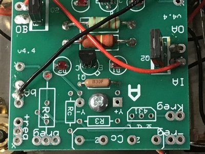

Offline PaulG
    • Posts: 26
last photo batch

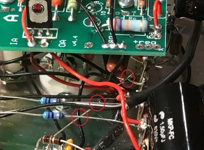

    • Posts: 20348
If the leads in the red circles touch, things will go very south in a hurry.
Offline PaulG
    • Posts: 26
In 3 d space the wire in the last pic have a reasonable amount of clearance.

Offline PaulG
    • Posts: 26
Must be time to dismount the left C4S board.

    • Posts: 20348
Well, you have a working board and a non working board.  You can pull each C4S board out and move it to the opposite channel to see if the issues move with the board, or you can reflow all the joints on the offending side and see if you notice any differences in the wiring/installation.
