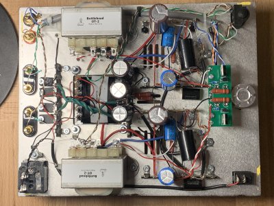

Anything look misplaced here?
EDIT: Weird, can't upload photos right now.

Reply #8 on: May 06, 2020, 03:29:42 PM
    • Posts: 20282
Reply #9 on: May 06, 2020, 04:31:27 PM
Nothing is jumping out at me there, everything looks to be about where it should be.

Something easy to try: tighten all the mounting bolts/screws of the terminal strips.  Many of them are used as contacts to chassis ground and so a loose one could make for an iffy ground connection.  I noticed that the terminal strip near the headphone jack has black domed nuts.  I'd make sure that the nut closest to the jack that is securing a ground reference is tight.  I'd also take a peek at the ground tab closest to the IEC inlet - the one with the bare ground wire running through to the ground lug on the IEC. From the pic, it looks like it could use a bit of solder (but maybe not -- might just be the angle of the pic).
