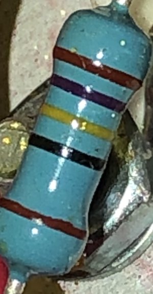

If the amp is stock, there will be a 182-ohm  cathode resistor on the paralleled driver triodes - pins 3 and 8 of the 9-pin socket. That should give 1.56v drop. Do you in fact have 182 ohms, are the triodes in fact paralleled? Your measured plate voltage is 188/220v, which would indicate a nearly dead 5965 - that's is why I am checking.

I checked the cathode resistors.  Both measure right about 173 ohms.

So I re-measured the driver cathode resistors, and got: 174.3/174. (I looked at them to make sure - looks to me like they are the 182R 1% they should be.  Photo of one attached.
