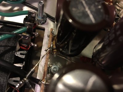

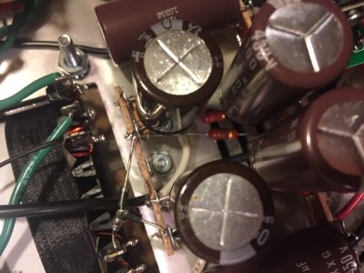

Completed a new build and resistance checks. Resistance between 8U and 8U was 1.4ohm by my (cheap) meter, so I used this as my "0" value. All resistance values were within normal limits.
Moved on to check voltage and upon plug-in the resistor between 44L and 30L sparked and smoked. I immediately pulled the plug.
I just re-ran the resistance checks, and everything checks out with the exception of 26, 28, and 29 which are now measuring around 2.3-2.6 ohm (after the resistor blew). These were all WNL last night.
I've taken a look at the solder joints throughout the high voltage supply (and everywhere really) and don't see any glaring issues.
The only other thing I can think of is that I initially installed the MJE5731A's backward and had to pull them and reinstall. They seemed fine, but may have been damaged in the process?
Never had a snag like this during a build, so any advice on where to start trouble shooting appreciated.

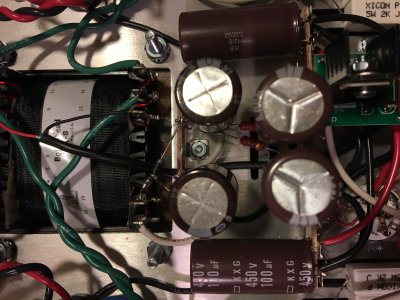

Please post some photos of your build. I suspect you either have a backwards power supply cap or you have the fat pins on one or both of the 2A3s plugged into the wrong holes in the 4 pin socket.  You have to push pretty hard to get the tube to fit in like this, but it is ultimately possible to force the tube in, then you'll start blowing resistors.

EDIT: Was able to get images uploaded. Originals were apparently too large.

Offline Tom-s
    • Posts: 505
Reply #5 on: May 16, 2020, 08:08:13 AM
Witold.
Look from all sides for wires that are touching.
There must be something shorted (to ground) that causes the excess current draw.
Maybe redo resistance checks now, to see if anything has changed?
Offline WK3K
    • Posts: 83
  • Beginning to see the light...
Reply #6 on: May 16, 2020, 08:59:34 AM
Hi Tom,
Thanks for the advice. Just looked at everything again. The resistor to B7 *might* have been touching B8, but that's the only thing I saw. I decided just to reflow each terminal to be doubly sure there were no cold joints.
I redid resistance checks — this time 8U to 8U was exactly 1.0 so I'm using that as my "0" value (previously was 1.4 - I'm guessing this is just a meter thing). Either way, every terminal was within 1-2% of it's value with all "0" values right at 1.0.

Offline Jamier
    • Posts: 382
Reply #7 on: May 16, 2020, 09:17:01 AM
Witold,
     Did you PM me? Where do I look for that? My personal email or somewhere on this forum? It may just be the perspective of the photo but the resistor (so possibly the lead) in question looks pretty close to the can(and possibly the leads) of that 100uF cap and possibly the leads of the preceding 220uF cap.

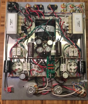

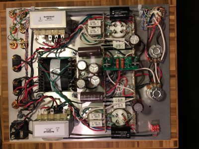

    • Posts: 20302
Reply #8 on: May 16, 2020, 09:24:24 AM
The image size thing is something we need to work on.  Could you try uploading a top shot that isn't reduced by so much?
With the 130 ohm resistor that got hot, are its leads touching any metal that they wouldn't otherwise be connected to?
After an inspection of the overhead shot with more resolution, I can provide you with some steps to split the circuit in half to see which half is causing your issues.

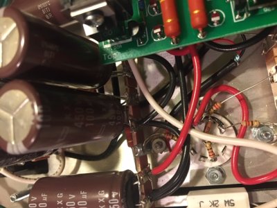

Jamie: I think the PM should go to the email that you have associated with your forum account. If you click "Profile" you'll see a little envelope where members can send you a note. Same thing if you click another member's profile. I'm pretty sure it's a perspective thing in the photo as the resistor goes down to the lower terminals and the caps are perched on the top of the upper terminals. There's a good gap there IRL.
PJ: I see no contacts on the blown resistor other than 270K resistor that shares 44L, the 130 resistor that shares 30L, and the 130 resistor that goes from 44L to 31L. The 130 ohm resistor that shares 44L and goes to 31L is just fine, so that might provide a clue?
Doc: Understand the limitations. I'll give it another go with images. I tried some single photos at full size and they produced the same error. Maybe it was just a timeout? I'll give it another try. [EDIT: worked to post one at a time by posting the text first and then "modifying" the post and adding attachments 1 by 1]

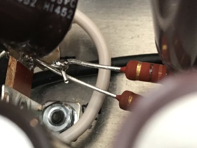

     I did not get your email. Try emailing me from your email providers webpage. I emailed you this AM from the forum's member page, did you get that? My correct email is the one that appears on the members page in this forum. If that doesn't work we will figure something else out to get you those resistors. Don't post your personal info directly in this thread! You probably know that already though.
Also, when you remove the bad resistor consider clipping the leads with plenty of length so you can create a hook on the lead to attach the new resistor to. This will leave the solder joint at the terminal strip undisturbed and anything else that is connected to it. I think the bleeders are connected there, I don't remember exactly.Also, clear this with PB. I did this when i replaced my blown 130/2W and it worked out well, but maybe he feels differently about this. I attached a photo of my repaired
130/2W.
