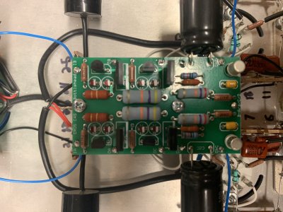

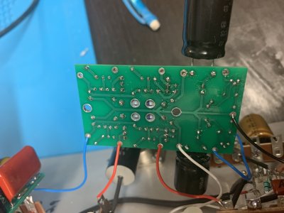

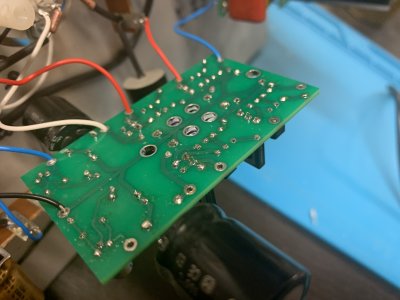

Hey Folks, got everything soldered up and going through the Voltage Check on page 76. The IB side of the board looks to be having acceptable voltage levels, but the IA is another story.  When measuring the IA side of the board my meter fluctuates from low to high and then overload for OC, OkA, and OkC.  I've checked the wiring and it seems *ok* to me but I've attached a few pictures in hopes that you all can spot something I'm not! I'm using a Fluke 87 V if there are particular modes you want me to check with.

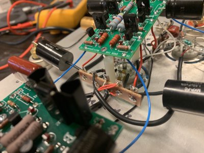

Reply #1 on: May 20, 2020, 04:03:37 AM
A few more shots

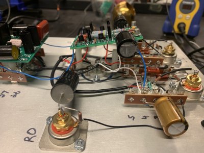

Offline nadamp
    • Posts: 11
Reply #2 on: May 20, 2020, 04:05:11 AM

Reply #3 on: May 20, 2020, 04:34:20 AM
The easiest approach might be to remove the board and reflow all of the joints on the offending side, with particular attention to the middle legs of the rectangular black ICs.
cheers, Derek
    • Posts: 20348
Reply #4 on: May 20, 2020, 05:07:43 AM
Your meter should stabilize on a DC voltage if you leave the probe on a given terminal for 5-10 seconds.
I would definitely pop the wires off of one side of the board, tilt it up, then reflow most of the joints on the board.  I would reflow every solder joint other than the HLMP6000 diodes, as those solder very easily.  I can see that your MJE350s aren't all that well soldered because the solder hasn't flowed through to the top side of the board.

After wiring the wires that would normally go to the ib side to the ia side.. all points measure fine. So it looks like it isn’t a board component.
After eyeballing everything once more I found that the capacitor for from the right channel wasn’t soldered to 21L. After resoldering all the wires to the side of the board they are supposed to be and reflowing the capacitor solder joint I have more stable readings, albeit strange:
