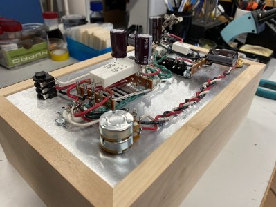

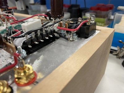

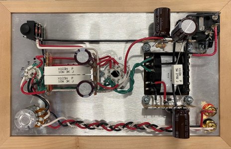

I'll post a couple of pictures now that this tread exists. I've never tinkered around with electronics much, only done a few small soldering jobs here and there. The initial build took me around 6 hours to complete and adding the diode mod maybe 30 minutes as I was hesitant to crank up the soldering iron to high enough heat from the beginning - that aluminum sure eats a lot and the wiring on my BY251 diodes was preetty thicc. Really happy to have bought and assembled the set!
Now off to find out if my DAC is the reason to it sounding a little flat to my ears.
