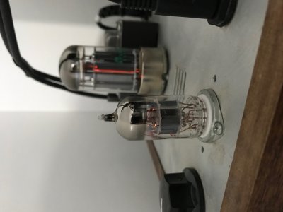

Yep, I can see light in both tubes. Here's a pic for reference
    • Posts: 20292
Reply #6 on: May 25, 2020, 05:22:59 AM
Can you post some build shots of the inside?
Neither half of your 12AU7 is conducting, so you definitely don't want to listen to this amp just yet.

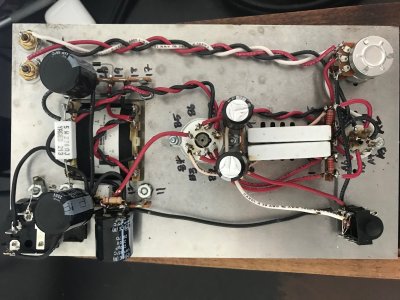

Offline cayoung05
    • Posts: 21
Reply #7 on: May 25, 2020, 09:01:17 AM
Hi Paul,

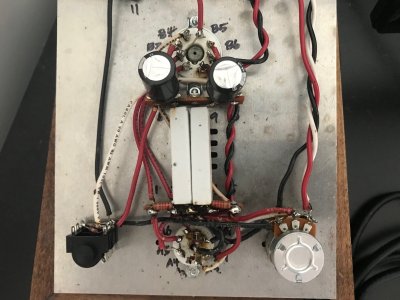

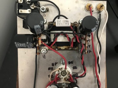

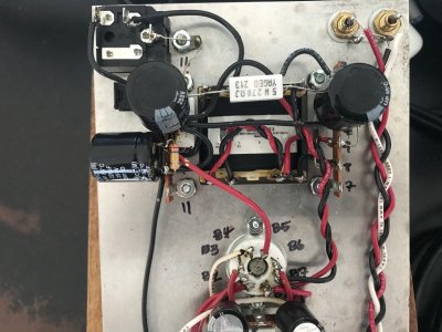

Here's some pics of the inside. I apologize for how messy the solders and the inside might look, it was the first solder job I did back in high school (which tells you how great and clear the manual was for learning/building an amp!). Let me know if you need additional pictures to clarify anything. Thanks again for your help,
    • Posts: 20292
Reply #8 on: May 25, 2020, 10:51:11 AM
It looks like pins 4 and 5 on the 9 pin socket have been forced together, then soldered into one lump.
From what I can see, I would remove the 9 pin socket, cut out all the wiring that goes to/from that socket, and rewire it.

Reply #9 on: May 26, 2020, 07:37:47 AM
The short wire from the resistor should go to A6 and not A5? Wire going to A5 then bridges across to A4.

Reply #10 on: June 02, 2020, 06:15:47 PM
Hey all,

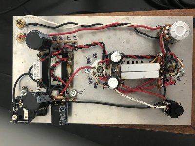

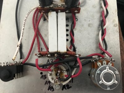

I rewired everything going to and from the 9 pin socket, replaced wires that looked suspect, and resoldered most of the joints, but the left ear still won't work. Here's a few pictures of the interior build. Any other suggestions? Voltages are pretty much the same as before:

    • Posts: 20292
Reply #11 on: June 02, 2020, 06:20:05 PM
You have a backwards LED on the 9 pin socket.  Please do not try to use any of our products that don't pass a voltage test.  The voltage checks tell you whether the amp is working or not, and trying to listen to an amp that isn't working could damage your headphones.
