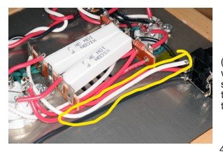

By the way, I followed the suggestion in this post, and it almost completely cleared up the noise. I am still going to do the Diode Mode, as I am still getting a very low but audible hum.
A note to potential Crack builders out there: The wires that connect to the headphone socket red and white as seen in my kit are often shown in the manual as running parallel to a bunch of other wires flat against the chassis. I found that having them like that would mean the wire closest to the wire group could pick up a 60 Hz buzz from one of the other wires in that collection: the red right-hand channel wire in my case. Be sure to lift them away from the other wires if you can, buzz gone...

It's funny, I've built dozens of Crack kits over the years and I always lay those wires flat against the chassis next to each other with nary a buzz.
