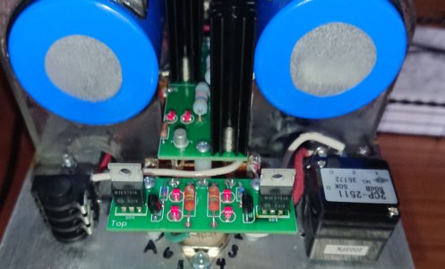

Could you post some photos of your build?
I just noticed that your OA and OB voltages are higher than their IA and OA counterparts.  Did you remove the boards when you swapped the transistors?  IA and IB go to terminals 2/4, while OA/OB go to 1 and 5.  Those could well be wired in backwards.  If they are not, you may have a loose black wire in the amp.

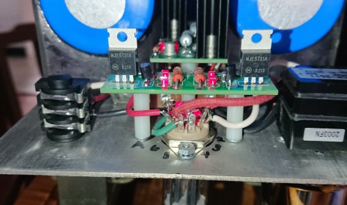

Images
Reply #8 on: May 31, 2020, 08:17:17 PM

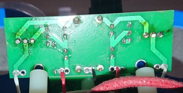

Can you take the mounting screws off the board, flip it up, then grab a photo of the bottom?  Did you buy those transistors from a reputable seller?  (eBay and AliExpress are not considered reputable)

Bought the transistors from a random Chinese eBay seller.  Images attached. My soldering certainly won't win any beauty contests.

https://au.rs-online.com/web/p/bjt-bipolar-transistors/1844907/
You'll have to do a side by side of the real ON vs. what you got if that ends up being the problem.  To be honest the ones you have look off to me for some reason, but I don't have any ON MJE5731A here to compare to.
