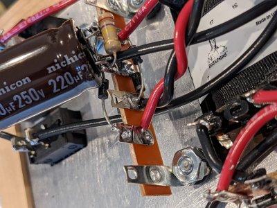

All of my resistance numbers are correct except for 45. I am getting a fluctuating number (i'm guessing because something is being charged by the multimeter?) anywhere from 3.00 - 6.00, depending on how long I have been using the meter. Any ideas?
