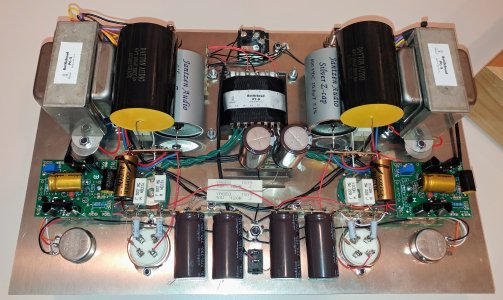

Something else to consider is replacing the stock electrolytic 100uF cathode resistor bypass with a film cap (e.g., Solen). Not as big of a difference as the interstage and parafeed couplings caps, but still noticeable (to my ears). But I don't think you can fit both a huge parafeed cap and a huge film bypass cap between the PT and the OPTs, particularly if you have the DC filament upgrade.
I managed it by using 3 x 3.3uF closely matched VCap ODAMs in parallel - they're pretty small, and sound very good (again, to my ears). I also "bypass" them with a 0.1uF Vcap CuTF.  It all just barely fits.
Note that a film bypass cap comes stock with the new Monomours.

They fit.

Hah!  But I don't think that would work with a huge Mundorf Supreme. That Superior Z looks to be moderately sized.

Well, that would obviously be insane.  However, a nice 10" x 6" open space would have been entirely reasonable and appreciated: http://forum.bottlehead.com/index.php?topic=11663.msg105881#msg105881  ;D
They were too big. So they ended up in my massive BeePre rebuild prototype - and just barely fit. They're coming out for the final rebuild (in progress).

The Miflex almost fit that bill: 8 1/4" x 3 3/4" - depending on one's standard for "adult shoe".

It should fit since it's a bit smaller (49 mm x 66 mm) than PB's 100uF Dayton Audio Cap (51 mm x 75 mm).
