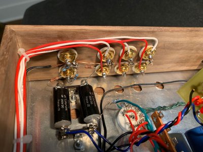

A little while back I picked up a Foreplay I kit that had been sitting in someone's closet for the last 30 years. I'm just getting starting with tube electronics, and putting it together was a great learning experience. It came with the Anticipation and Sweetest Whispers upgrades, though I only installed the former. Once I had it running in the original configuration I started thinking how I could make it better for my tastes and purposes. I built a new case for it out of thinner walnut with a lower profile, moved the PT underneath the chassis inside the case, moved the input and output jacks to the back of the case, replaced the dual volume pots with an Alps Blue Velvet stereo unit, added a choke in place of the second resistor in the CRCRC network, replaced the coupling caps with Solens, added 100k resistors at the outputs to attenuate the output level a bit (without them the gain was just ridiculous when matched with my Lafayette KT550 power amp) and got a matched pair of Tung Sol reissue 12AU7s.
The thing sounds great, but it's got a pretty pronounced 60Hz hum. I tried to replicate the grounding scheme as much as possible when moving to the new chassis, but with the move of the i/o jacks I did have to make some changes. Like I said, I'm more or less a complete beginner, so I'm not sure where to start with tracking down the hum. It’s in both channels, is unaffected by input source or volume control, though there is an additional, slightly louder 60hz buzz over the top of the hum when I touch the volume pot. I’ve also tried moving things around (various wires, the Anticipation circuit boards) with a chopstick and no movement seems to make any difference in the volume of the hum.
Any suggestions for things to look at? Any obvious mistakes I've made with the grounding scheme? Pics attached. Thanks very much for any input.

In the original setup signal ground goes to the grounds for the volume pots, the CF/VA boards, the cathodes of the first section of each tube, and the heater center tap of socket B (pin 9), then to terminal 13, and finally a line ran from there to terminal 1. I put a jumper from 1 to 3, connecting the circuit to chassis ground at the first filter cap ground, and there only. With that configuration, I didn’t get any hum.
Now the signal ground goes to a jumped dual terminal strip near the volume pot. That strip is connected to the grounds for the volume pot, CF/VA boards, the cathodes of the first sections of each tube, and the heater center tap of socket B. Finally, a line runs from that jumped terminal back to terminal 1.
To my thinking this should be effectively the same as the original, but maybe I’m missing something. The only effective difference I can see is that now the output signal ground comes after the input signal grounds.

* Finally, posting some photos of the wiring is a big help.
I don't understand your 100K output resistor - can you clarify?

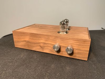

Very nice and very original take on the vintage BH kit.

I looked at the photos again more closely, and I see the 100K resistors, along with some resistors to ground whose color code I can't quite read - are they the original 470K? If so, the combination increases the output impedance from 1K to 82K - way too high to drive cable capacitance, and can much more easily easily pick up hum by capacitive coupling. Also, the resulting attenuation is very small. You could change the 470K to 10K, which will reduce the output impedance to a hair less than 10K, and will reduce the output by 20dB - including any hum.
The wiring layout of the original was not that great, and yours is somewhat worse, primarily because the path is longer. Ideally, the signal and ground wires should be bundled together all the way to the tube and then to the output jacks - the idea being to minimize the loop area enclosed between them. (I see that you have done this with the Anticipation boards.) That will be a big job, so try the 10K first!
Yep, those are the original 470k resistors. I saw a couple other posts here on the forum about attenuating the output like that, but I didn't see anything there about adjusting the output-to-ground resistors, so thanks for the suggestion! Sadly, I replaced the latter with 10ks and though that does seem to have improved the bass response  a bit it had no effect on the hum. The gain is still a bit much for the power amp--at 1/4 volume it's already way louder than I'm ever going to use--but it's workable. Really, the Foreplay probably isn't the best match for the fairly sensitive KT-550. But even with the hum and some imbalance in the voltages at the #1 sockets (I had to replace a couple of the LEDs and I think the forward voltage on them doesn't match), the Foreplay sounds way better than the $100 SS headphone amp + pre-out I've been using as a volume control so far.
I re-checked the resistances and voltages and all is well there (except for the imbalance I mentioned above, but I don't think that would be causing hum?). I reflowed all the solder joints, and also installed a 3-prong plug with the ground connected to terminal #3. Alas, no joy with any of it.
I'm not opposed to tearing down and revising the wiring layout. This is all part my process of learning about tube circuits and aside from just getting rid of the hum I'd like it to be right. Can you expand on the "big job" changes I might make in the wiring layout, given the custom chassis? What would be the ideal layout?

OK, it looks like we are still at square zero. I would expect the 10K to affect the treble slightly, but not the bass. And it would certainly make a substantial reduction in hum that's generated upstream of the output jacks.  Does that mean it's generated in the power amp? ... there's no certain way to know without gathering more information and thinking logically about it.
At a guess, there is something wrong with the ground connection - could be cables, could be RCA jacks, could be internal wiring, could be something I didn't think of. I suppose a simple test is to see whether the hum is present with the Foreplay turned off, or with the tubes pulled out, or both. For each case, check the hum at full volume and with the control all the way down. If your meter has an AC voltage range, try to measure the hum voltages as you do these checks. That might guide you in the process of checking the wiring. There's no point in fixing small things that might be an issue until we fix the big thing(s) that are certainly an issue.

You have the chassis earthed back by the power supply, I would move the ground connections for the power supply caps off the chassis terminal and to the power supply negative terminal instead, then break the connection there between the PSU negative and chassis earth.
Move the ground wire that you have to the other side of the chassis so it runs up front around the two blue power supply caps.
Earth the signal ground up at the front of the chassis, probably best done on that 3 lug strip you have up front.
I can't see the second power supply filtering resistor in your build...
