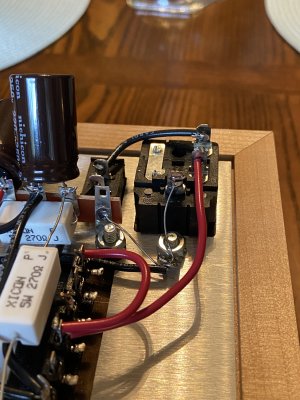

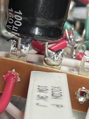

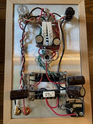

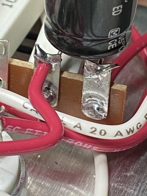

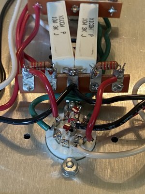

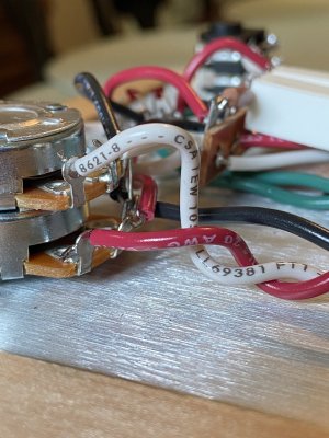

I've also posted some pictures of Terminal 7 and my headphone jack.

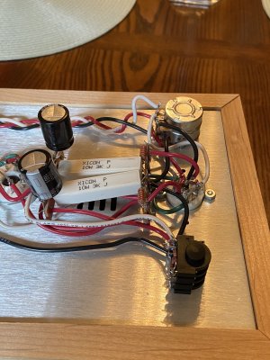

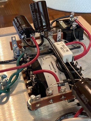

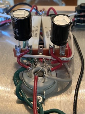

Can you post some less zoomed in photos of the whole build?

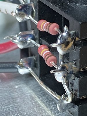

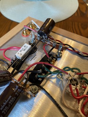

I have attached a number of photos of my build including an overhead shot that encompasses the entire build. I included shots of my 9-pin, 8-pin, and various angles of the build. Let me know if you need a shot at a specific angle.

Reply #11 on: September 01, 2020, 08:04:32 AM
Your solder joint at A5 could definitely cause some problems.
Otherwise, things that would make terminal 7 0V:
B1 and terminal 5 are connected by a wire and should have the same DC voltage.  If they don't, that could be a problem.  The wire at B1 could be wrapped around the tube socket contact and crimped around it.  All your connections should be crimped on the terminals/socket pins if possible.
Either end of the 3K resistor between terminal 3 and 7 not being well connected would cause this issue.  Resistance checks should catch that.
A backwards cap at 6/7 would cause 0V at 7, but that's not what's going on here.
Miswiring the connection that goes from 6 to the headphone jack and instead sending it from 7 to the headphone jack will make 0V at terminal 7.  It will also do so much more damage that it can't be what's going on.
The wire from 7 to B3 could be broken or not well connected.  B3 should show the same DC resistance that 7 does, could you double check that?

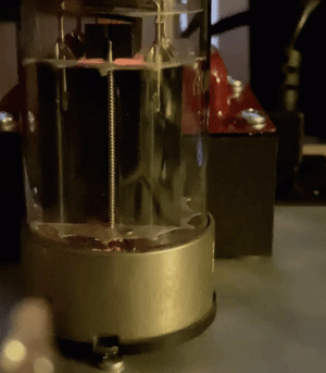

UPDATE: Upon powering on the system the pop occurred again. However, this time I noticed that a blue charge occurred inside the GE 6080 tube triggering the audible pop from the headphones. I should note that I am not wearing the headphones when I power the system on. I was paying close attention to the tubes this time to see if I saw anything, and the blue charge and pop occurred right when the 6080 tube began to glow (few seconds after powering it on). I unplugged my headphones and gear after powering off the system. I turned the system back on with no gear attached to it, and the blue charge occurred in the middle of the 6080 tube. Hopefully, this is some useful information!
