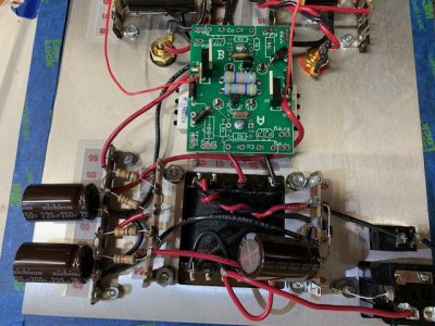

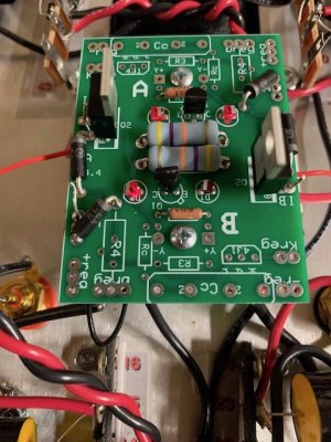

Just finished the Shunt Regulator board and one of my LED's is not working...Not sure what to check to see what is wrong.
Pic attached.
thanks

Reply #1 on: September 19, 2020, 07:58:01 AM
There's a voltage check on page 23.  Can you let us know what you get for that voltage check?
I see lots of long leads poking out of the top side of that board, which makes me want to see what's going on underneath the board as well...

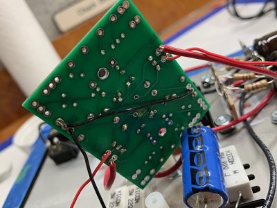

Sorry that was sloppy, I just did not snip the leads on the connection wires from the preamp...did now.  Pic of underside attached.

Reply #3 on: September 19, 2020, 09:13:35 AM
You may have solder bridging two terminals on the bottom side of that board, and that would cause some of your issues.
You gave me three voltages and didn't assign them to terminal numbers; the manual lists for terminal numbers to check... Did you have 6922 tubes in the sockets when you performed this set of voltage checks?

Chuck Ditter
Reply #5 on: September 19, 2020, 09:23:38 AM
I would absolutely reflow every solder joint on that board other than the LEDs as well.

I think I found a solder bridge between two pins of the MJE5731 on side B...fixed that with some solder wick.  Reflowed most all the joints.
Reconnected and now all 4 led's light.

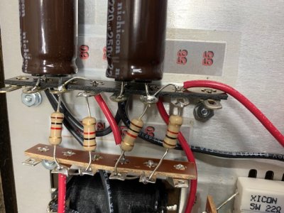

No, the tabs on the MJE5731As should read lower than terminal 56.  Can you post some photos of the power supply and where you have the extra 1K resistors installed?  Also you didn't mention whether you had the 6922s installed, but I would recommend installing them if you do not have them in already, then repeat these tests.

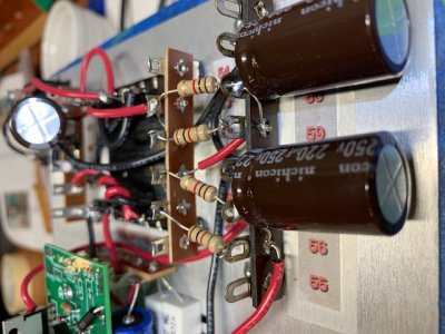

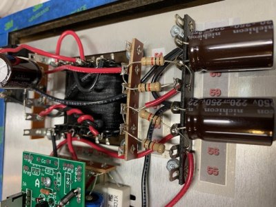

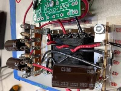

Photos requested attached, let me know if you need more.

All of the joints in that photo should be reflowed, possibly with a little more solder added.  Heat them up till the solder liquifies, then wait for it to flow where it wants to flow.  It doesn't look like the flux has flowed out of most of those joints.
