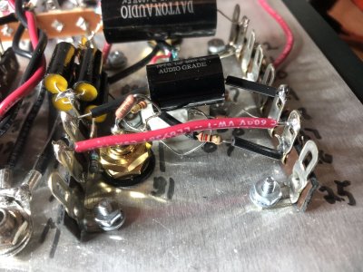

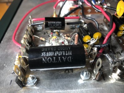

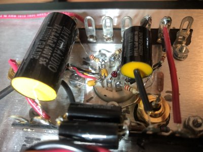

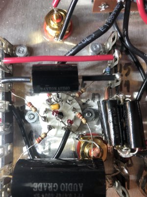

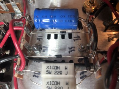

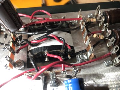

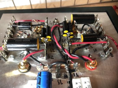

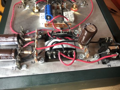

Attached are pictures of my build. This is my first project, and electrical in general. Tried to follow suggestions but am sure my soldering will not win any awards.. be kind :-)

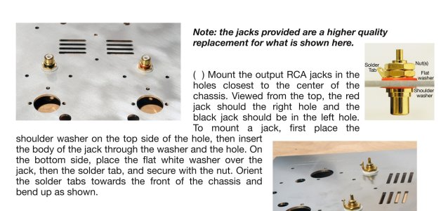

Are you 100% certain you have the RCA jack hardware in the proper order?  I've seen this kind of situation pop up when the hardware on the RCA jacks is left in the same order it comes in from the factory, which isn't correct.

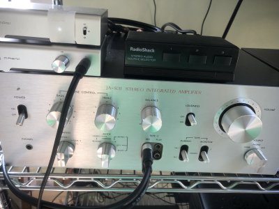

I've been using the P2 on the phono stage of my 1976 JVC JA-S31 for about a year, no hum with the cables in the correct sided RCA connections on the amp side.
I hear the hum on this amp if I don't have the black side connected.
For grins I tried switching the turntable cables on the Reduction, red to black, black to red, still have a hum

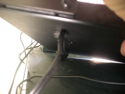

For all this I think the turntable is setup correctly. I would have to open the tone arm to do this? See picture.
Tried connecting Reduction to my Schiit Magni, still have hum
Pictures of my setup...

He’s suggesting the RCA Jack hardware is improperly installed on the amp, I think. Maybe review the RCA jacks and make sure they have the washers and nuts installed as the manual says, which is different than how they come out of the package.
Yes, this.  The correct order is shown on page 13.

I see exactly what you mean.
Printing out the manual lowers the resolution of these images. I totally missed that until I looked at the digital version

I'm looking at the front page of the manual, at the RCA tabs. The washers next to the body are all white.
Are these supposed to be the black and red colored washers that come in the kit?
If so could you please send me a closeup picture of the topside of these RCA connectors?

I would suggest reading the text in the manual, as it calls this all out very specifically.  The color of the washers isn't important (the photo is of the jack we used to use).  The order is very clearly laid out and the photo on the top right of the screen grab I posted shows the jacks we provide currently.
