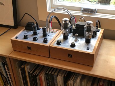

Just finished building my Moreplay. Hooked it up to my Stereomour to test it out. Sounds lovely. Eventually it will go in to my desktop system, fronting my Seductor.

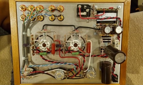

A few minor issues with the instructions:
Pg. 24 instructions say to attach a black wire to the L tab of the IEC inlet, it should attach to tab N. Also the instructions say to attach the other end of the wire to 34L but leave out soldering it.
Pg. 41 instructions say to attach wires to A3 and B3 and do not solder. However nothing else gets attached to these terminals so I would think they need to be soldered at this point.
Pg. 59 voltage check lists a DC voltage of 225-275 at terminals 10 and 20 however nothing is attached to these terminals so they read 0.

That's looking nice.  How are you enjoying it ahead of your Steremour?

Very clean build, the layout should compliment your Seductor well.

Into my Stereomour, which is hooked up to Klipsch Heresy IIIs, the sound with the Moreplay is slightly fuller. Without it the Stereomour plays plenty loud enough into the Heresy IIIs, but I would describe it as leaner. Not sure yet which I prefer. Given that the Stereomour has volume control and input selector I probably wouldn't have thought of adding the Moreplay in front of it. I've always felt the Heresy IIIs were a little bass shy in my system so I'm really liking the sound with the Moreplay...
No noticeable microphonics, the selector switch is quiet and doesn't pop when changing. Plus, it's nice to have a balance control.
This is a really, really nice preamp.
Phil

The errors posted are accurate. I know of no others than those mentioned here.

On page 51, the red and black wires from the selector switch to the lower front and rear lugs of the balance potentiometer say to attach and solder on the balance potentiometer, but there are more connections to make on those, so don't solder those two lugs until later.

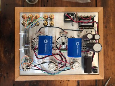

Beautiful build. But why did you leave those old beer cans (Hamms?) inside? Aren't you afraid of them shorting out something? :o. I'm waiting for my Moreplay kit in the mail. YooHoo. So I appreciate your comments and photos. It's been a long time since I soldered up a kit of any sort. I did a Heathkit receiver and a metal detector kit about 40 years ago. I have a nice workstation set up already and have been practicing soldering skills. I'm a Scotch drinker so I won't be leaving any beer cans in my project.
