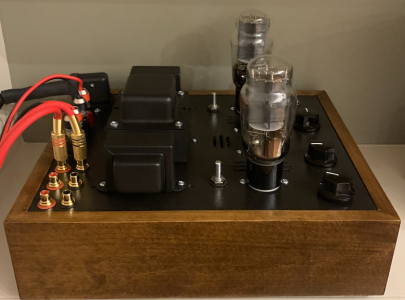

PS - including a photo of my system, in case anyone's curious...
