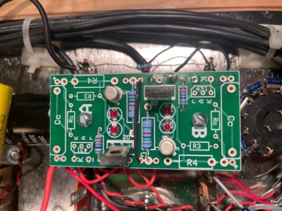

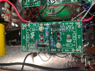

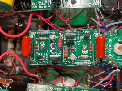

In the initial build on the left C4S board I had put the MJE350 where the 340 was supposed to go. Those are corrected now. I had also made a silly wiring error connecting the right board, which I've now fixed.
With the right and left tubes out, but center 12AU7 in:
KRegA - 1.9
IA - 219
OA - 152.8
KRegB - 1.93
IA - 219
OA- 150
Pics of boards attached; I solder on the bottom per the instructions so only solder on the top of the board is for the wiring. Oh, and the H1-2 voltages are also lower than in the manual if that means anything. - thanks again!
