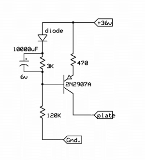

I've also build the original PJCCS as per PJ old scheme on AudioAsylum (here in attachement, please note that the capacitor should go around the resistor and diode)
