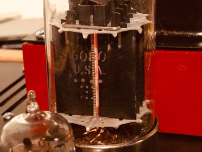

Reply #3 on: December 05, 2020, 05:43:58 AM
Can you post a picture of the red plating?
Offline grosen
    • Posts: 53
Reply #4 on: December 05, 2020, 06:17:22 AM
Not sure how to post a pic.  Let's see if this works.
https://postimg.cc/7J405T1j
Reply #5 on: December 05, 2020, 06:19:45 AM
I don't see any red plating.  I do see a nice hot cathode sleeve, but that's totally normal.
Offline grosen
    • Posts: 53
Reply #6 on: December 05, 2020, 07:02:17 AM
That’s great. Thanks. I wasn’t sure, but it looked unfamiliar to me, and like some of the pics of red plating on the web. Good to know it’s normal.

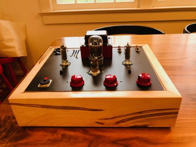

Bonus pic of amp.  All stock with eccentric paint job and ambrosia maple case.  Thanks to Paul for chiming in so quickly.
Deke609
Reply #8 on: December 05, 2020, 08:42:02 AM
Very nice! Painting the stock knobs is a really cool touch. I don't recall seeing that before. What kind of paint did you use?
cheers, Derek
Offline grosen
    • Posts: 53
Reply #9 on: December 05, 2020, 10:06:03 AM
Thanks.  The knobs and transformer edges are Rustoleum Gloss Enamel red.  The plate and the transformer cover are Rustoleum Oil Rubbed Bronze metallic.
Offline johnsonad
    • Posts: 1670
Reply #10 on: December 05, 2020, 12:40:43 PM
That's a nice looking build!
Reply #11 on: December 05, 2020, 12:48:43 PM
I like the maple a lot.
