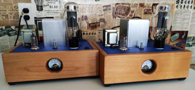

You can drill holes in the wood base to add meters.

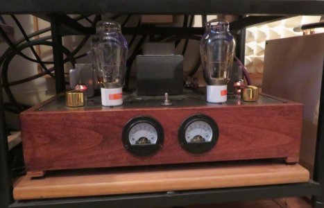

I added a couple of meters.  Pretty straightforward procedure.  Now for one last question:  both channels of my Kaiju have 72 mA of current going through the cathodes.  I assume that as the tubes age, the mA measurement will go down(?). At what point should I become alarmed and think about getting replacement tubes?

Nice job Larry! That looks great and a really nice looking build!
Thank you, Aaron.  I still plan on springing for the Takatskis you recommended.  A matter of when, not if.

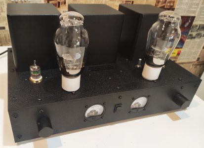

Is that true of the MonAmour 2A3 as well or is the meter more useful in the 2A3 topography?
    • Posts: 5907
Reply #13 on: February 21, 2021, 03:20:17 PM
The MonAmour has a switch which changes the 2A3 plate current, and in the high-current mode it requires a modern 2A3 with higher plate dissipation rating than old-stock 2A3s. So the meter indicates the current to help prevent accidentally risking older tubes.
Thanks for the explanation P.J. That is a very useful feature indeed. You guys always think of clever stuff like that.
