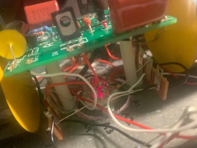

"On the 9 pin socket, do both LEDs glow about at the same brightness?  I would suspect a solder joint on that board isn't quite right. "
It appears that both LEDs glow about the same brightness levels on the 9 pin. I've attached pictures below.

I know my soldering skills can use some work. More photos are in link:

This may be unrelated to the hiss issue, but in the 2nd pic (pcb), it looks like you're not using enough solder, or not enough heat, or both. I can't see a single solder joint where the solder has been drawn up to the topside of the board.
I can't see the solder joints elsewhere in the amp, so I have no idea whether the pcb soldering is reflective of a similar issue elsewhere.  But flaky joints could cause noise.
Subject to what PB says, you might want to post some detailed pics of the soldering in other parts of the amp.
cheers and good luck, Derek

I would agree that reflowing all of the PC board joints other than the LEDs would be a good plan.
