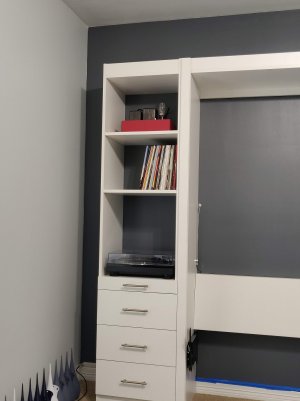

Looking for some ideas or inspiration. I am in the process of installing a murphy bed into the room that will double as my listening room. I have been taking care to integrate the audio gear into the furniture build process.
The MonAmour amps are going to get a dedicated shelf on the cabinets beside the murphy bed. I figured by putting them up high they will be safely out of harms way and as far removed as possible from some of the other potential interference creators. What I would like to do is mount the amp plates in the vertical plane so that I can see the amps in all their glory.
There is a good amount of space around the amps so I think as long as any new stand is well designed then ventilation shouldn't be an issue.
I'm generally fairly creative and not bad at solving these types of issues but I am drawing a bit of a blank here on how to tackle this. There is a lot of weight to be managed on the front of the plate. I've gone from just a large lump of wood with a channel cut in it to stand the plate in and hope the weight will be managed, to trying to design (in my head) a whole new box that will hold the plate and protect the rear from misplaced digits, but still allow access if required.
Any thoughts or ideas, or similar concepts you can point me in the direction of for inspiration, would be greatly appreciated.
