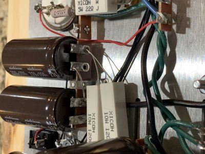

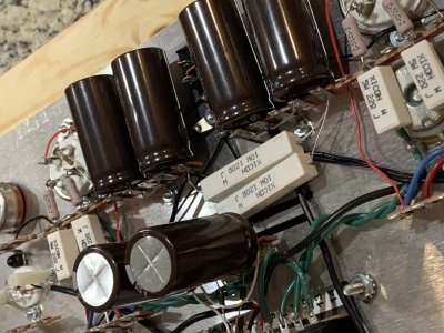

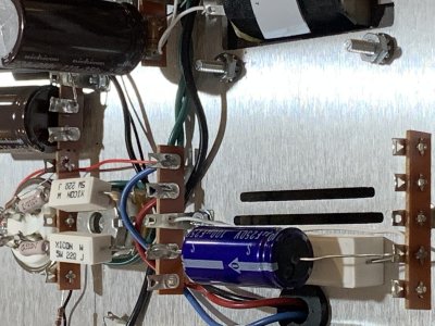

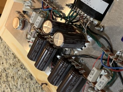

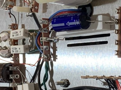

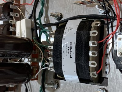

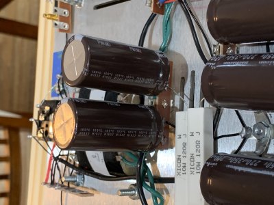

Can you post a pic of the transformer and wiring around it?
Offline Jm8542
    • Posts: 17
Reply #2 on: December 31, 2020, 08:52:18 AM
Hi Derek thank you. Let me know if the photo's I added to the original post help

It may be helpful to know what your mains voltage is. What country do you live in? I do not have a Kaiju but by the voltages you posted
may indicate improper primary wiring on the transformer.

USA! USA!. It looks like one of the diodes attached to the power trans at terminal 8 is cut. Perhaps it is just the photo but I would investigate.
Deke609
Reply #6 on: December 31, 2020, 11:29:29 AM
Nice spot Lee! It certainly looks like that first diode lead is broken on the transformer side.
If that's not it, I wonder whether some part of the voltage doubler isn't making contact. My guess would be the white wire that connects 37L and 41L. Or maybe one of the two 220uF caps that attach to that same terminal strip.  I'd try reflowing the associated joints. And make sure the teflon jacket isn't inserted into the lug hole and preventing connection.
IMPORTANT: before touching anything, use your voltmeter to make sure there's no high voltage left. If there's a problem with the white wire at 37/41, the bleeder resistors (or one of them) may not be able to do their/its job.
cheers, Derek

Hi Derek and Lee. You were right it was that Diode that was cut!! I repaired it and now the measurements read:
236 vs 250DCV
543 vs 490DCV
256 vs 250DCV
All within SPEC!!! Thanks again for your help.
