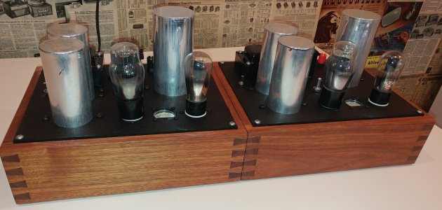

as it happens, I have a couple pairs of early prototype OT-2s with the wrong number of turns, giving them around 5K impedance.
You gave those to me years ago (unless you have more?) and they went into some 45 amps (in wood bases/stands that Dan gave me years ago, also out of his basement).

    • Posts: 634
Reply #14 on: January 22, 2021, 02:28:24 AM
PB, those 45s look PDF for using gifted parts!
