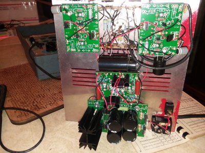

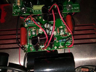

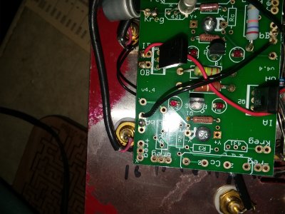

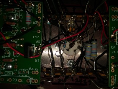

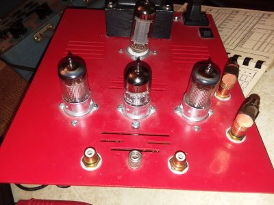

Photos of the build.  Hope this helps.  If not let me know.   PS, I just checked the voltages again and the are the same as before.
Online Paul Birkeland
    • Posts: 20252
Reply #10 on: January 21, 2021, 08:43:27 AM

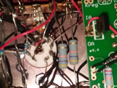

I would go through and be sure things like the leads of the 47K resistors aren't touching other leads that cross over/under them.
The 4V at Kreg means that the DC servo is trying to pump the brakes really hard on letting the EF86s draw any current, but your 6922 plate and cathode voltages are almost shorted together, which makes me suspicious of the wiring.

I checked the 47K resistors and  all of the other resistors and wiring about the plate.  It all looks good and nothing was touching etc.    Looking very closely with a bright light, it all looks good.    In addition, I took a shot and installed a fresh 6922 tube.   The voltage at the kreg dropped to 3.     By the way when I explained that I put a tube into the wrong slot, that was not on the Eros, but my tube tester.     I will continue to trouble shoot as best I can.   Like I mentioned before, this has been working for 9 or 10 years.    I have not done any wiring on it for that amount of time except for adding some Mundorf caps years ago.  I can continue to review the wiring which will happen, but something tells me it is a possible component issue.

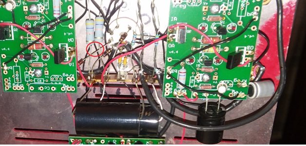

Reply #13 on: January 21, 2021, 10:15:24 AM
As an example, this kind of short would drag the plate voltage of the 6922 sections low and cause the servo to go high on the EF86 cathode.
Offline Ascari
    • Posts: 42
Reply #14 on: January 21, 2021, 10:26:00 AM
Thanks Paul.     That is exactly what I went looking for, and they are not shorting out anywhere that I can see.   Sorry about the photo quality.    I should get my good camera out,
