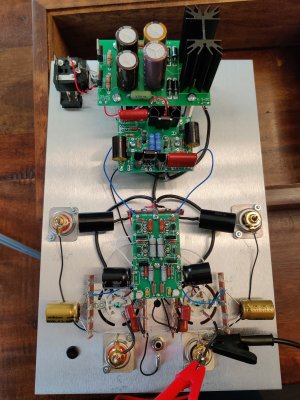

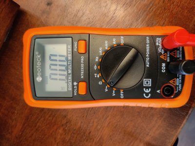

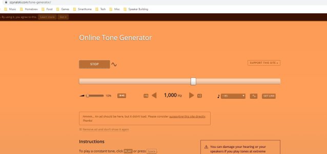

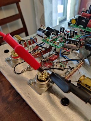

Reply #10 on: February 10, 2021, 10:20:49 AM
I have attached several pictures of what I am working with and how I am testing.
    • Posts: 20302
Reply #11 on: February 10, 2021, 12:32:07 PM
Try 60Hz.  The red clamp that you're using probably isn't a good idea.  It looks like it's touching the center barrel of the RCA jack and the outside of the RCA jack, which will short out all the signal and give you a 0V reading.
Your meter specifies a 2V scale for AC so it should work properly to take these measurements.
From what I can see of your build I would add a little solder to just about all of the solder joints and a lot more heat.
