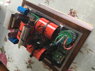

I used the Panasonic’s EZP film caps they fit nicely down one side and the t you can get a choke on th3 other side. Take a look at this site, apparently the should fit but you’ll have to use both sides of the panel.
https://www.headphonesty.com/2019/04/upgrading-bottlehead-crack-headphone-amplifier/
It’s full of lots of sensible info. I used the setup pictured on there
Good luck
Martin
Offline Jimb0
    • Posts: 304
Reply #2 on: February 25, 2021, 06:33:09 AM

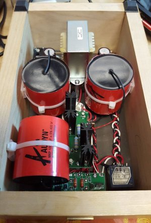

Thank you for that info Martin and was really helpful in getting the measurements of these caps. I do not think the 100uf Audyns will fit because the EVO Oil Mundorf's that I used barely fit and those were 50mm in width. The Audyns are 60mm so if I were to get them they'd have to be installed outside.
Deke609
Reply #3 on: February 25, 2021, 06:57:47 AM
To test whether they'd fit, you could cut a 60mm diameter cardboard circle. Then turn the Crack upside down (with suitable supports to keep the chassis in the wood enclosure), and see if the circle can be inserted without hitting the wood side or a heatsink.

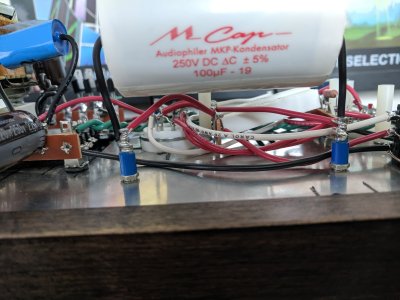

I used Mundorf M-Cap ... 100uf, 250V.  It's 66mm L x 56 mm Diameter.   That Audyn cap is slightly smaller so yeah, it should fit assuming you havent added anything along the sides.

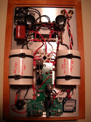

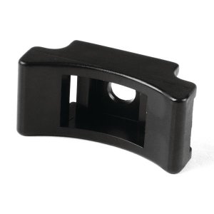

I drilled my top plate and screwed down the zip tie mounts, 2 per cap.  No way was I trusting the double sided tape to hold those big caps over time.  I used small, button head, square drive bolts.  Hated to drill the top plate but it really doesn't look bad and much better than dealing with falling caps.
