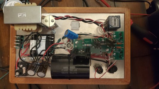

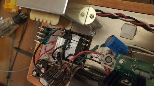

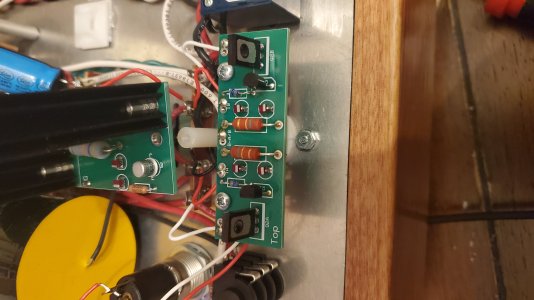

Can you post some photos of what you have going on right now?
Offline Mesz77
    • Posts: 32
Reply #6 on: February 25, 2021, 12:31:11 PM
Let me know if you need more than these
Brandon Meszar
PSU
Reply #7 on: February 25, 2021, 12:38:19 PM
I see Doc B. has increased the maximum image size we accept on the forum!
So you have an Alps blue pot installed without a PC board.  Those break when you connect wires to the pins.
Is that a pilot light you've added?
The white wire on the headphone jack looks like it might not be super well soldered.

Lol I didn't realize the images were so huge! The white wire to the headphone jack looked and felt pretty solid, but I reflowed it and still no left channel. I suppose I'll reflow all the pins to the alps pot now. That is a pilot light that I installed since I kept on forgetting to turn the amp off!

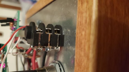

I think I may have found the issue but I want to double check. Whenever a pair of headphones is plugged in, are all three of these pins on the jack suppose to look separated like in the image?
I wasn't getting anything through the left channel after reflowing parts of the alps pot, but while listening I poked the very top pin in the headphone jack so it would touch the plate across from it. It was separated like the other two pins, but not as wide as them as you can see in the image. I got audio in both channels whenever this happened, and the pin went back to being separated like it was before after poking it. The audio remained in both channels so I ran a left/right channel test from youtube through the amp to make sure it wasn't the right channel coming in through both channels. It's definitely working now, but the top pin on the jack concerns me. If I pull a little bit on it to separate it more I lose the left channel completely.

The tip contact won't separate as much as the ring and the sleeve do.  That's normal and what I see in your photo. If you poked that top contact down so it touches the other side, that will cause your left channel to short to ground and it will drop.
I don't suppose you're using a 1/4" to 1/8" adapter?

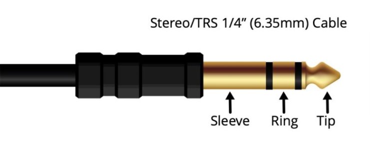

With your headphones plugged in, you can measure the DC resistance between ground and the tip, then ground and the ring.  They should be about the same.
The ring is the connection on the HP jack where the red wire lands.
The tip is the connection on the HP jack where the white wire lands.
