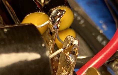

I tried to reflow 11L from both sides.  I then checked continuity all around 11L and 11L, including right on the lead to the capacitor (see picture) and I got a beep for continuity.
I can certainly keep trying to heat things (worry about damage if I do too much, you tell me otherwise!), but theoretically if I damaged the resistor, would that cause my issue?

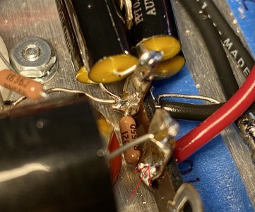

Reply #5 on: March 03, 2021, 01:23:41 PM
Sure here.  This is after I reflowed, so it got a little messy.  Some of the texture is from the point of the test leads scratching the solder.  I soldered both sides on this to see if it helped, before it was just the front.
I generally cut the leads long, solder, then trim.
« Last Edit: March 03, 2021, 01:26:02 PM by canonken »
    • Posts: 20296
Reply #6 on: March 03, 2021, 01:26:42 PM
The solder joint of that resistor where the 0.47uF cap connects looks a little cold.

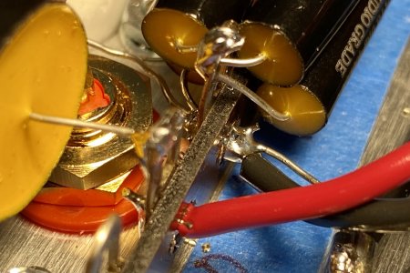

Reply #7 on: March 03, 2021, 01:35:24 PM
I soldered it from the other side, and have been scratching it with the test leads.  It had a full wrap of the wire around the lug before I soldered.  I do have continuity between the cap lead and lug.  I shook it hard and it does not move.
    • Posts: 20296

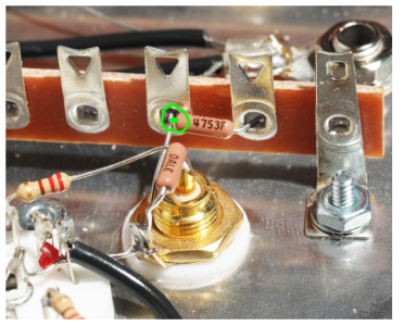

Reply #8 on: March 03, 2021, 01:57:33 PM
This one.
