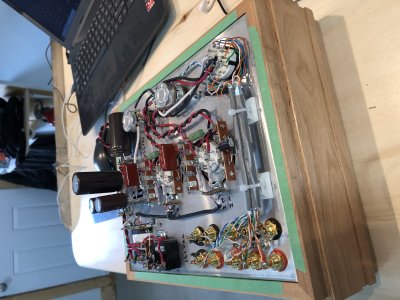

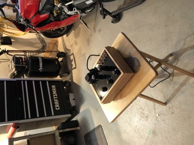

Hi all,
Just finished my Moreplay. Really enjoyed the experience and sound. It sure warms up my solid state system.

Nice job on the build
Debra

@debk,
Thanks. This was my first build since I was a kid. Definitely not my last. I am mapping out a system in my head now. I am sure it will change along the way...

Reply #5 on: March 31, 2021, 04:29:33 AM
I like your take on the base.
"Definitely not my last." BH kits are like Lays potato chips...

"BH kits are like Lays potato chips..."
Ha - Same can be said about motorcycles. Thanks for noticing the base. 5 minutes on the router gave it some shadow lines.
