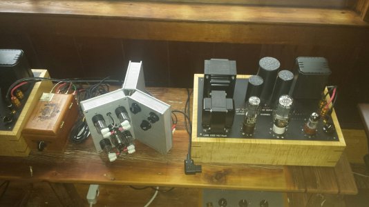

I was looking specifically at the Lundahl 1664's for the Output iron. Did you build your amps from a known schematic, or cook sumpthin' up yerself? I've not seen that specific Don Garber Fi Y you've got there...

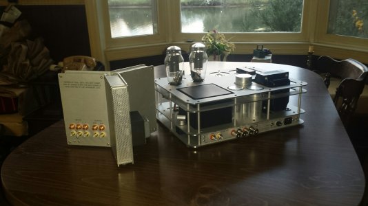

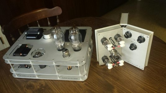

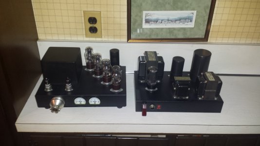

The Don Garber Y pre is of my own design using a modified BH Foreplay III circuit The 300b mono's are from an old Joseph Esmillsa
schematic with some changes, I also recently completed a 2a3 stereo amp in a Don Garber inspired aesthetic. All using Lundahl 1664's
as well as a parallel 1626 amp I built around 2001. The 2a3 stereo and 1626 uses Hammond 1590vbk enclosures to house the 1664's.
